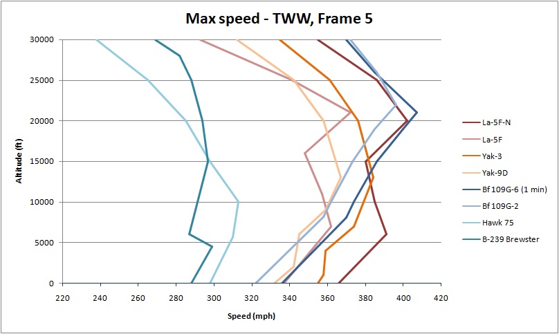

---== FRAME 5 ==--- (Summer/Autumn 1944)
* The Bf 109G-6 only has 1 minute of WEP. As such, refer to the G-2 speed curve for the normal performance of the G-6.
* The G-6/RVI is 5 mph (8 kmh) slower than the G-6, and also rolls somewhat worse.
Image _ Image
Image _ Image
