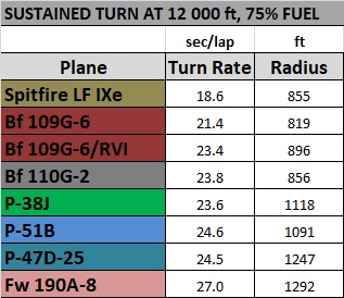

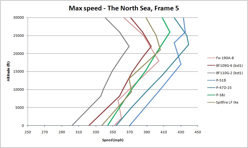

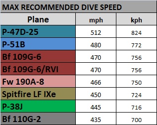

PostPosted: Fri Dec 18, 2020 2:02 am
Here is a plane comparison for frame 5.
Do note that the Bf 109G-6 and Bf 110G-2 have their speed shown at Bst1, since Bst2 has a 1 minute only limit. At bst2 the Schmitts adds ~15 mph to their top speed, up to 21 000 ft (6400 m).
Image - - - Image
