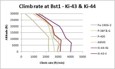

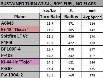

---== THE NAKAJIMA KI-43-II HAYABUSA (PEREGRINE FALCON), "OSCAR" FULL REHAUL ==---
The Ki-43-II was a Japanese land based fighter designed for superior maneuverability. It was light and had a good wingloading, fielding the Nakajima Ha-115-II radial engine capable of 1174 hp at 2800 m (9200 ft). This engine is quite similar to the Sakae 21 engine of the A6M3 "Zero", and in fact the Ki-43-II is very similar to the A6M3 in both speed, climb and turning performance. It has a low top speed for it's era, but has an excellent turning performance. It's dive performance is very poor so the Hayabusa will have a hard time catching Allied fighters diving out. The armament is also quite weak with only 2x 12.7 mm machine guns in the nose. That being said though at slow speeds it's an excellent fighter that can easily outmaneuver and out turn fighters of the same era, and it was quite liked by the Japanese army pilots. It's butterfly low drag flaps are also great for turn fighting.
---== THE NAKAJIMA KI-44-IIC SHÔKI (DEMON), "TOJO" FULL REHAUL ==---
